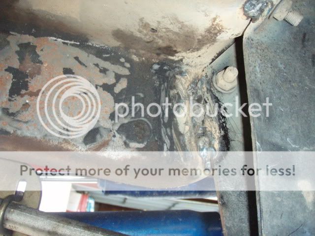

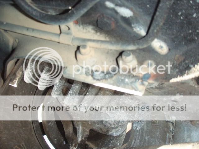

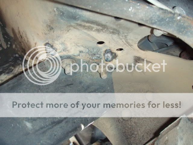

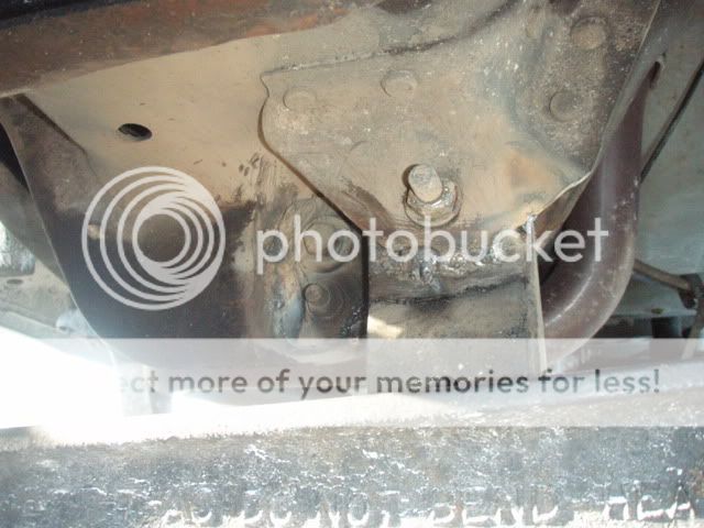

heres some mediocre pics lol
the first bracket i was having issues reaching as the drag link and steering stabilizer was blocking most of the areas...
looks like a mud-dobber nest: ill grind down and re weld on friday
everything else was ok to pretty good for someone who rarely welded
i know the welds arnt perfect, im still learning. i just cant take that rattling front end anymore!!! lol

just keep practicing. making a bead is the hardest part after that its all technique.
just keep cleaning them up and redoing them till you are satisfied. I might do some welding soo ill post my results

usually the shitty looking weld hold... usually
