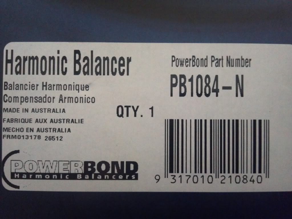

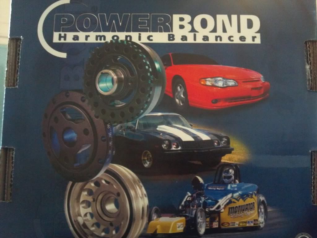

The Napa website said my local store had one available........... it was wrong. So i go to O'R's and picked up theirs for $59.99. So much for saving a buck. I thought i was buying a Dorman but got this instead.
I have never heard of the brand before nor have i ever bought an Austrailian made part before. Everything has been Chinese, Japanese, or American.
The install proved to be a bit more than i thought. Mainly in getting the old balancer off. I really was hoping i could do it without taking out the radiator. No such luck. I had to pull it in order to get the electric impact in there to get the balancer off. But everything else went smoothly.

Got to be WAY better than Chinese and Japanese parts! Probably better than mexican parts as well.
