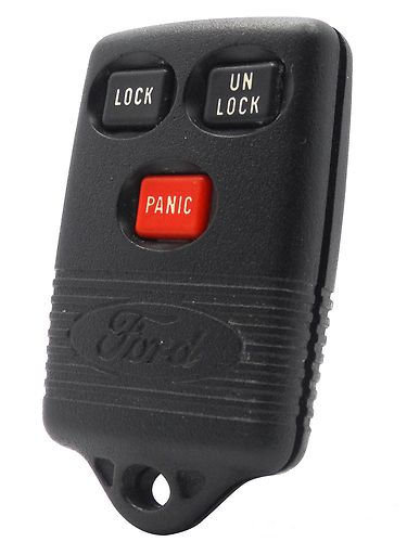

So, I purchased an original 90's remote off ebay.
I found plenty of info online on how to program a remote for the Bronco. I found the programming connector under the steering column no prob. When I jumped it, it was supposed to cycle the locks, but nothing happened. I tried with the doors closed and opened... still no cyling.
The truck came with an old aftermarket remote and noticed the that the wire to the speaker was cut also. I didn't trace to see if even the grey programming connector was cut or not though...
it was lost in there... my locks didn't cycle...

pry it open and ad a drop of MMO
