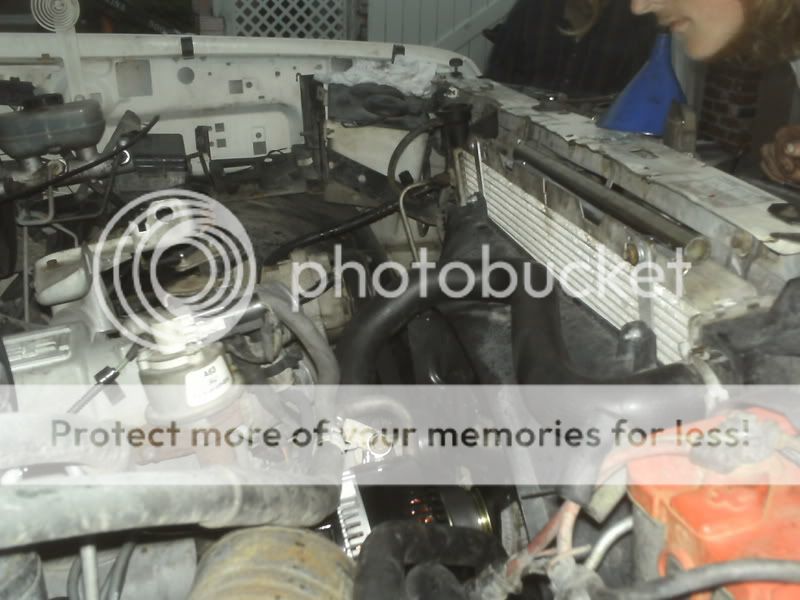

11/07/09--well i finally have a weekend off! been trying to work on pulling the motor out of my donor truck but its hard to do with a lack of help. got all the accessory brackets off and radiator removed. im having a hard time removing the exhaust. the bolts on the manifolds (y-pipe to manifold) wont budge even with a impact wrench or breaker bar. broke out the saw-zaw for the old exhaust... i should have the motor pulled by tomorrow afternoon and on the stand.

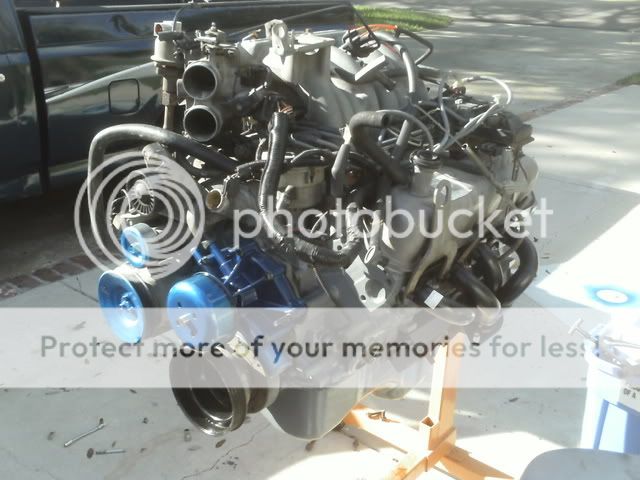

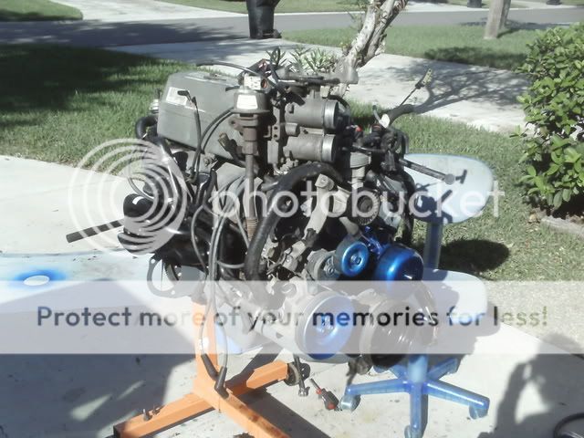

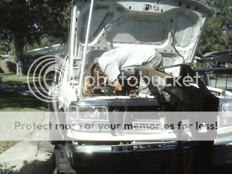

--got the motor pulled out of the truck this morning... i sanded the oil pan down as the paint was flaky on the bottom and re painted. changed the water pump. it didn't need it but extra insurance. i should have the motor in on friday if im off and the weather stays clear (tropical storm!)
i also soaked everything under the hood of my truck with degreaser for 3 hours and pressure-washed the frame rails. after it dried i tried that Dupli-Color rubberized undercoating on the cross-member and frame rails. looks really good. now i need to paint the firewall as some of the paint was blasted off lol
i also scrubbed the block down and repainted it but it got dark before i could snap some pics
351 out and on the stand:
after i pressure-washed the frame:

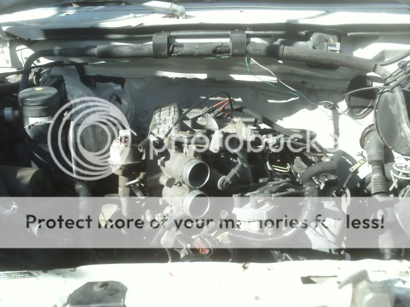

i was curious about the differences in wiring harness between the 5.0/5.8, i checked my Chilton's engine harness diagram for the 5.0 and 5.8 and spent the last hour comparing the 2 and everything is the same between harnesses. everything is in the same # pin location between the 2 harnesses. i'll give it a shot with the 5.8 harness first as is is in way better condition than my harness (i ended up using my 302 harness as i was lacking top end power.)

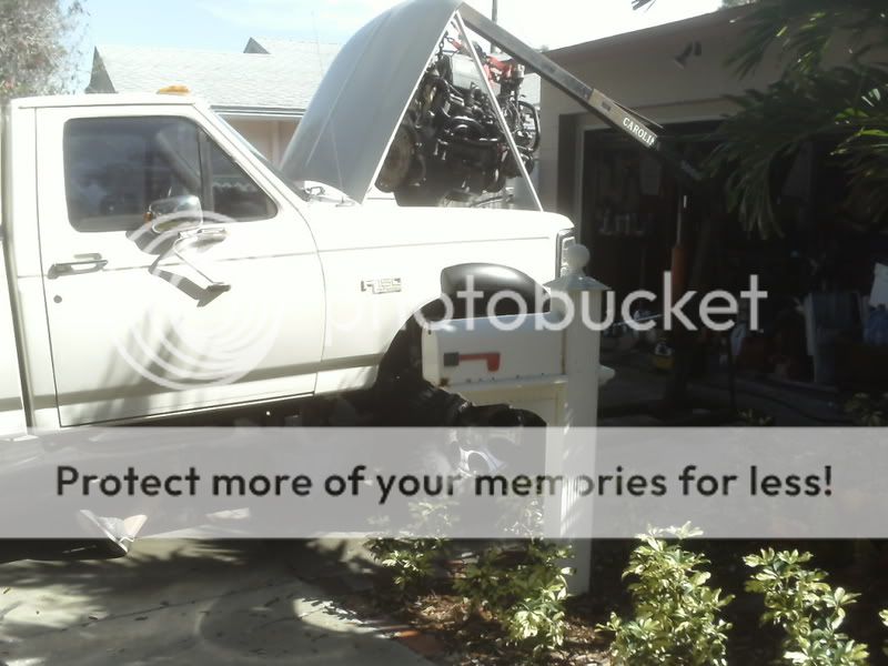

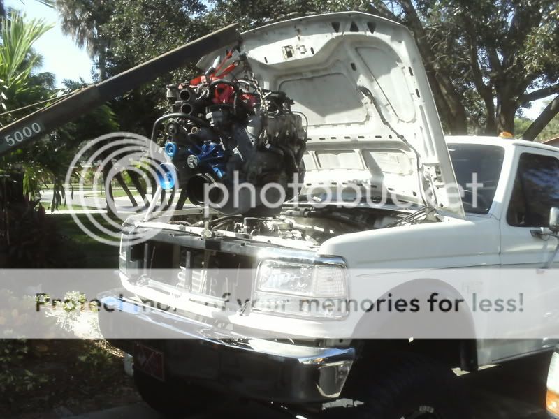

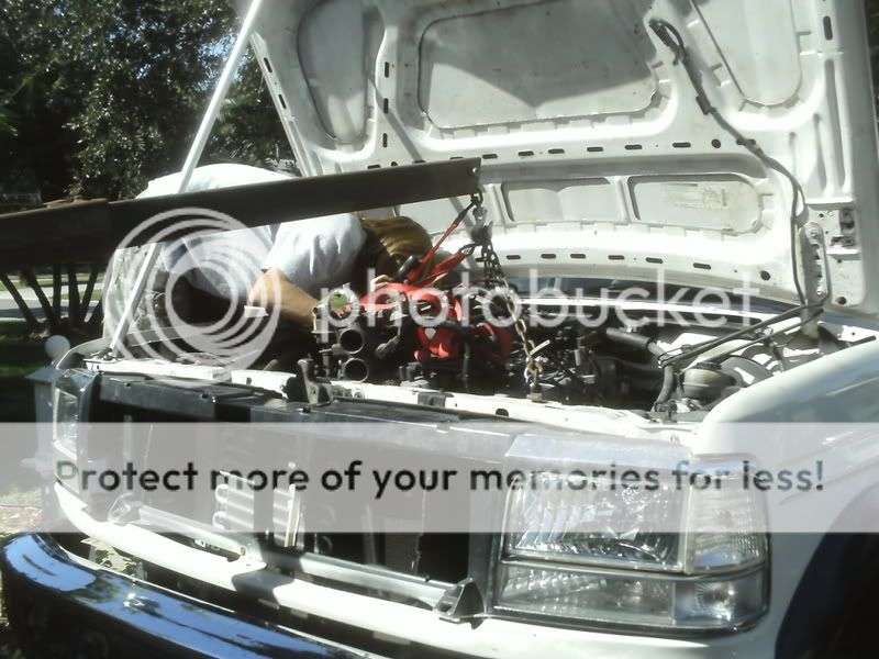

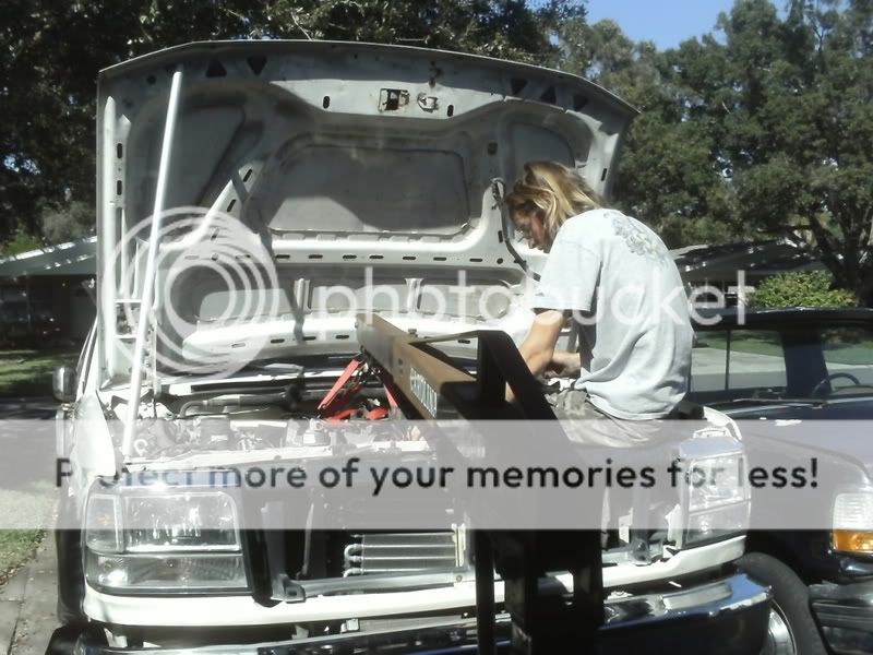

11/13/09--well im off today! waiting on the fedex truck to get here with the shorty headers and exhaust system... heres some pics of the motor after touching up with paint and adding a little bit of color, and the frame rails/cross-member after coating it

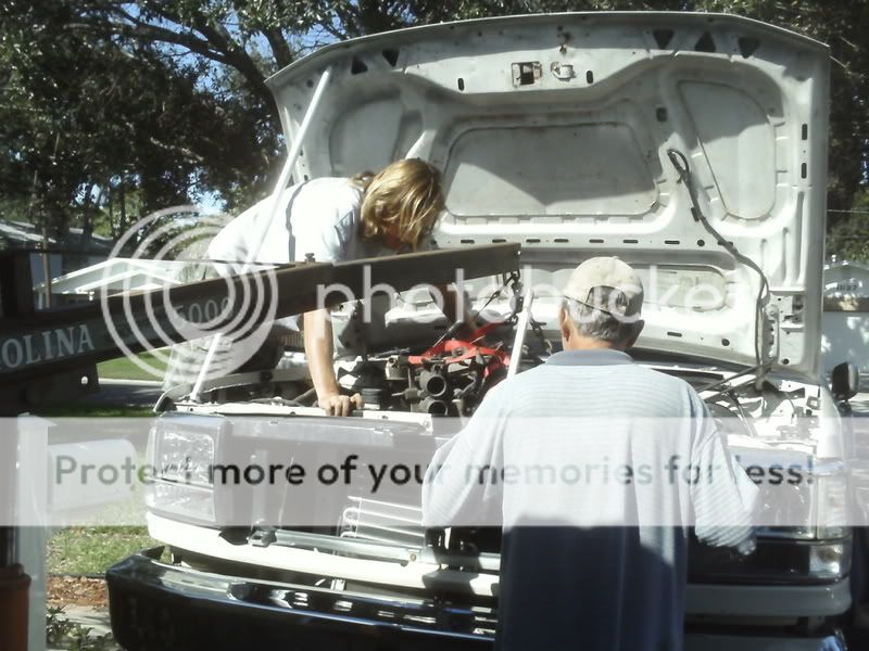

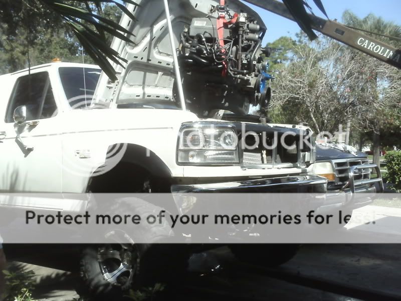

11/14/09--i got the motor in the truck today!!! it is almost done, just gotta bolt and weld up the exhaust. it starts and runs AWESOME! idles perfect, revs great, no hesitation. at first it did but i found a vacuum line came disconnected. i used the 5.8L harness as my harness was in real bad shape...(again, i ended up using my 302 harness.)

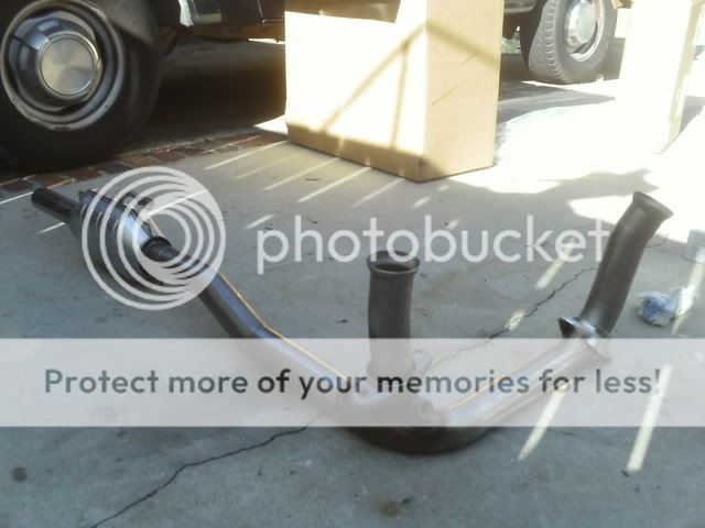

anyways heres the exhaust, magi hi-flow, super 44
