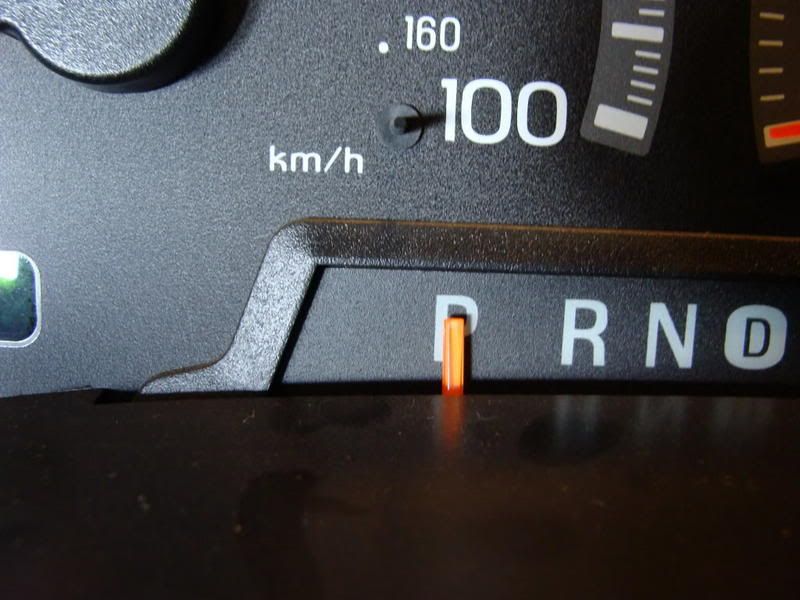

If your shifter pointer does not sit (centered) properly
on its respective letter then this How-To is for you!
Look under the dash at the lower side of the steering column and locate this black adjuster:
Once located, pinch and spin adjuster until the needle is correctly centered to the "P" letter.
Here is the final product: The instrument cluster needle in my F150 centered and ready to go!
