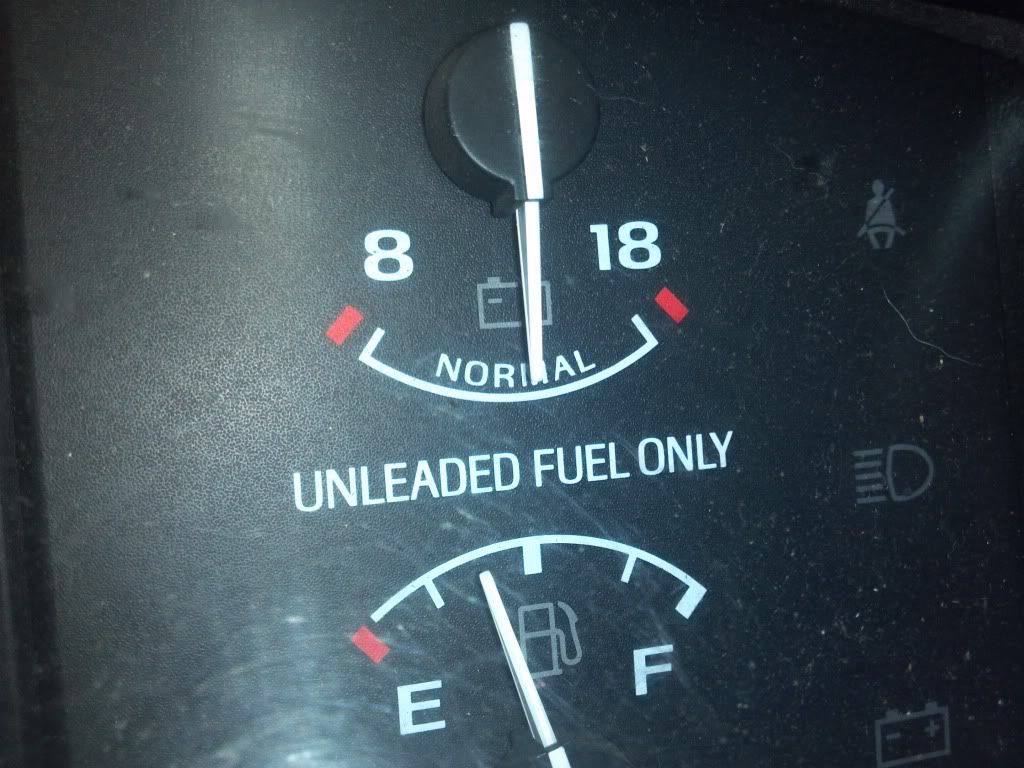

The last week i have noticed my volt gauge acting a little weird. When i drive without the hvac fan running the needle sits between the R and M in normal. When i use the fan it sits between the N and O and it doesnt fluctuate with more engine rpm. The pics are a little deceiving, they were shot at an angle.

I'd test it with a multi-meter when you have the fan on vs. off, check at the battery to see how much amp's the alt is cranking out.

Today i drove it to Alba, MO and back (40 miles RT) to get a guitar for a buddy of mine and i had no issues with charging at all in fact it may have been over charging a tad bit. The needle sat in between the M and A the entire time. Im still going to purchase a new alternator in the near future, this one just bugs me a little. I tried putting a multi meter on it but the battery it was dead. I have an old Sears engine analyzer i put on it and everything looked ok. For a second opinion i had O'Rielly's test it and they said it seemed fine.
Old July 13th, 2012, 09:24 AM
At idle it should be 14.4volt +\- 10%, if you are going to get a new alternator, upgrade to a 130 AMP 3G. You should have a 3G already, but it's most likely a 95 amp.
