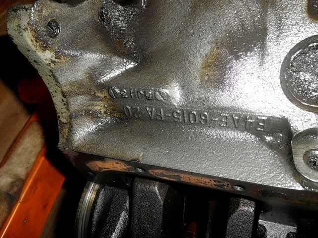

The 302 that came out of my red 90 has got me stumped. I looked in the usual location for the block identification and well...... it's not there. I have picked Blue's brain about it and searched the www to no avail. Normally its on the passenger side rear of the block and there is a riased plate cast there to have the ID cast onto it.
Here is a pic of how it should be (courtesy of Blue)
and here is the difference without the raised plate or ID.
Anyone have a clue? Blue and i discussed the possibility of it being a "hecho en mexico" block but everything I've seen on the web points to those having the same ID plate cast as every other windsor block has had since 64. Aftermarket? Generally most aftermarket blocks I've seen are listed as "seasoned" or reman and i would think they wouldn't grind that plate off.

That raised part is cast in the block, then the date is stamped, there's no plate, looks as if it were cast without a raised part, that's why I thought foreign block or reman or aftermarket.

Not sure what heads are on it, haven't got that far yet. When the mexican block thing came up in conversation with Blue I decided that a set of gaskets were a small price to pay to see if "hecho en mexico" was cast in the oil valley. All the info i could find on the mexican block said the id was in the same place as the others at the p/s rear of the block with a C8 designation. So i think i can rule that out. I even found one source saying unmarked blocks were used by racing teams from NASCAR to SCCA. I doubt this was used in NASCAR because they never ran 302s. This weekend i will likely pull the intake and see what may or may not be there. Hell, i may start tomorrow, idk. I will also try and ID the heads too. Correct me if im wrong but didnt the FI manifolds only work with E7TE and GT40 heads?
