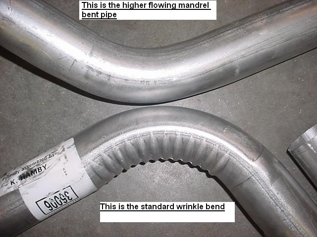

PS: if you do get a set or buy one I recommend that the bends be 'mandrel bent'

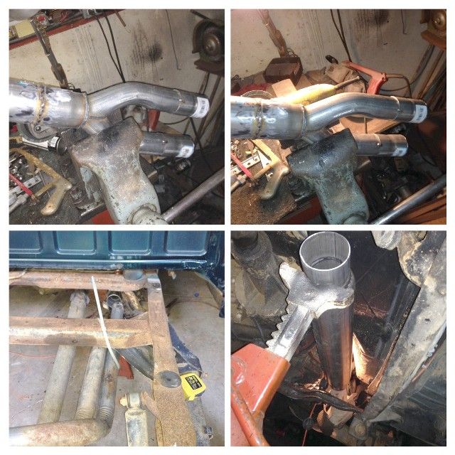

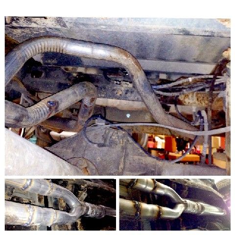

I had duals on one of my parts trucks that ran from the manifolds all the way out back. My fixer-upper exhaust was cut off behind the first cat. A muffler and "Y' connector from Summit, my old pipes, cussin' and blood later and it was done. Mine is 3" muffler into 2 2.5 pipes.My 2 cents wort advice ..... have a muffler shop do it and skimp somewhere else!
Oh and mine is a 4.9L so wrinkle bend was ok (and free) since you don't use the word "performance" when speaking of a tractor motor!
