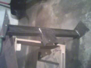

so i finally have an update, i got my tranny crossmember welded up and installed, i will post some installed pics when the snow stops. i now have 4wd again and fixed my tracbar problem by welding the washers to the bracket!
materials:
37" 2x4 tubing 3/16" wall
1/4" plate for sides and trans bracket
3/8" gussets under center extension
1995 F-150 4x4
4.9l m5od 3G swap
8" lift D44 SAS
35" Mud Rovers

trac bar making a clicking, almost popping noise was it?
nice heavy looking crossmember.
