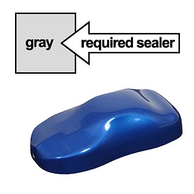

I've been looking through the summit racing catalog and I think I've narrowed the paint colors I want down, keep in mind this will still be Tu-Tone Blue and White, just a lighter shade of Blue than what's on the Bronco. The two colors are Blue Sky Metallic and Bahama Blue Metallic:
B S Metallic:
B B Metallic:
Now I've just gotta pick the color, I'm leaning towards the Blue Sky Metallic.

I like the B S Metallic:
