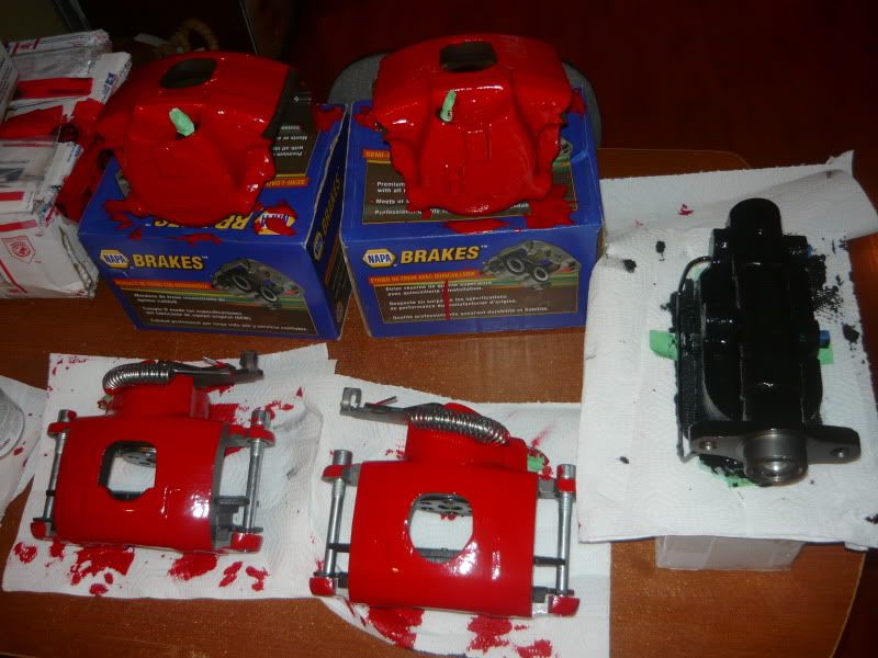

I came to a point with my truck where I had almost enough horsepower but not near enough brakes. I had seen a good article on upgrading late '70's trucks with one ton brake components. I started putting together the parts and finally last winter was able to get everything installed:
I bought a rear disc brake kit from Blackbirds
Next I picked up a set of Thunderbird front calipers which are a direct bolt on with a bigger piston. I painted the calipers and master cylinder.
Decided to upgrade the front rotors also.
Rear discs installed.
I was going to use a 1 ton brake booster but decided on a hydroboost setup. The braided lines were not neccesary but do look good.
I used stainless tubing for all hard lines and braided lines for all the flex lines. So was it worth it? That's a big YES!!!!!!! Not cheap (but could be done much cheaper). Braking feels as good as a new vehicle, before it took a strong push and hope you had lots of room, now it's a light touch and you're almost through the windshield.

be sure to use heat proof paint on the calipers
