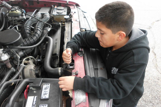

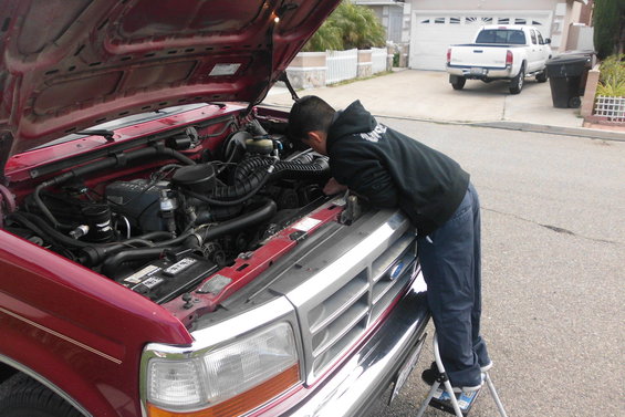

I had a leak in the radiator a while back that I sealed with the powder stuff. It actually held for several months but, I knew I had to replace the radiator. So, I found a new stock replacement locally for $100 and a new gator back serp. belt on ebay for $11. Which I'm glad I replaced because I found two deep cracks on the old belt.
My boy did most of the work...
