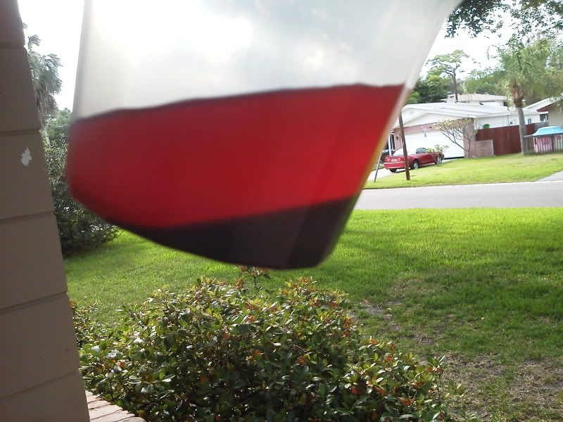

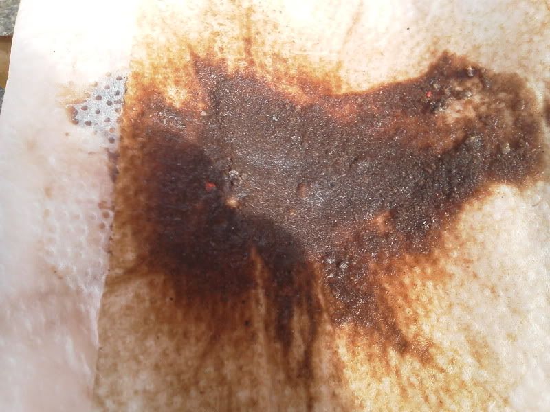

changed my coolant filter this afternoon for the first time, was supposed to change it about 300 miles ago but a drive to boca grande this morning took priority
those who own a 6.0L and dont have a coolant filter.... GET ONE ASAP!!!!
the crap ford coolant and sand left in the block will forever clog your EGR cooler and oil cooler...
this is what came out of a filter with about 900 miles on it, after a coolant flush was done at 136,000 miles
yes that is sand
that drill bit is a 5/32 bit, you can see how large some of the pieces are
the closest CAT dealer/parts place is 30 miles away on the other side of the bay, this is the kind at NAPA that is equivalent to CAT EC-1

Correct me if I'm wrong but that is sand from the block casting process? Yikes!!!!

yes biker

ive read about some 7.3's having sand left in the block causing wear on the water pump.
the problems with the cooling system is sand clogs the oil cooler and egr cooler, and the ford gold coolant has silicates that cant withstand the high temperatures from the egr cooler. the silicates start to gel up and clog the egr and oil cooler... thats why so many are now recommending CAT EC-1 or equivalent coolant
