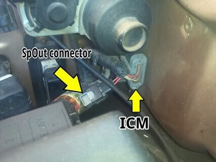

I dont think the ACT and ECT needs to be warm to test voltages. Either they are in range (good) or not. With the code 212 check to make sure the SPOUT connector is there. It should be on a pigtail hanging from the distrbutor and grey in color.
This is a pic of my setup but the SPOUT connector is the same. And again, hanging from the distributor.
As far as the torque converter clutch issue, it could mean it needs to be replaced. Try clearing all the codes and start over again with the engine at operating temp. Also hook your EGR back up.
Hope this helps and lets us know what the outcome is.
