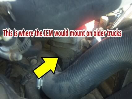

Sounds like a bad Ignition Control Module (ICM) On a 92 I think they're located down on the side of the distributor. If not, it will be up on the D/S inner fender near the firewall.
Mount on distributor
Firewall
Old September 20th, 2013, 12:03 AM
1992 Should be distributor mounted ICM.
