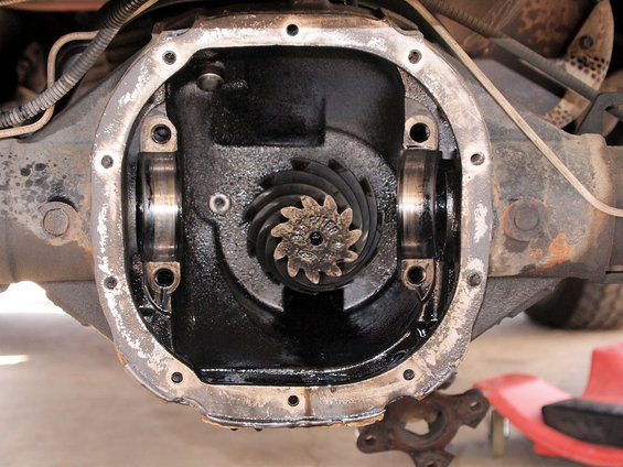

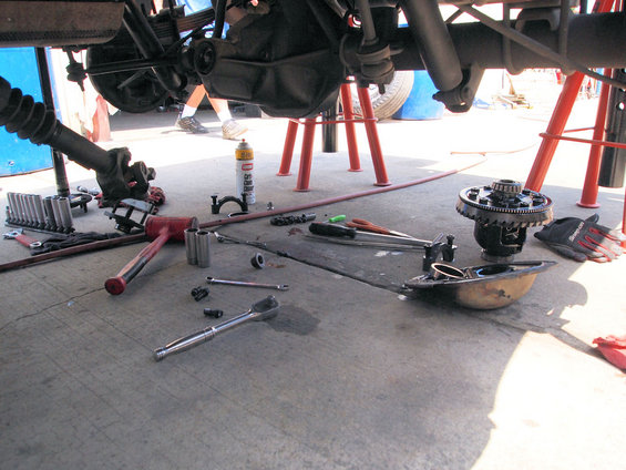

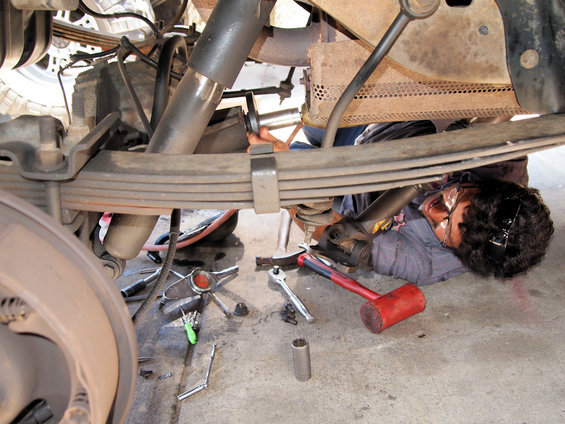

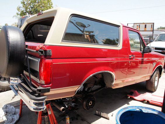

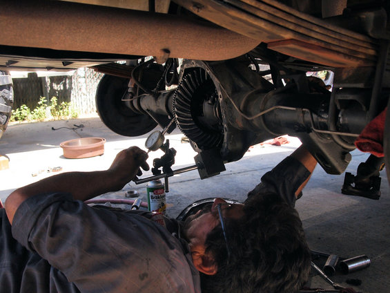

Started hearing a growl coming from the rear end a while back... took it to my buddys place and started digging in.
Turns out my pinion bearing was worn and so was my pass side axle. My ring and pinion showed normal wear. So I got a master kit bearings and seals and replaced them all. I still have to locate a 31 spline ps axle.\
Once everything was buttoned up, we noticed a slight vibration coming from the rear drive shaft. We took that out and noticed the u-joint werent rotating smoothly... which we assume is what caused the pinion bearing to out. So, im the hunt for rear drive shaft or just replace the u-joints...
Our friend whos an actual mechanic did the work...

Looks good, but why is there only 2 clutches in your limited slip carrier? You could bump it up to 3 which is stock or 4 which is a higher performance version, which I did and love, so far.
